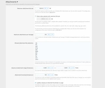

I believe my admin CP values are correct :
197019
I have tried to set the value of the max attachment image dimensions to null and 0 - it made no difference.

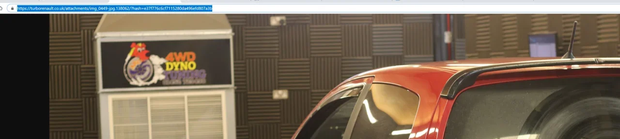

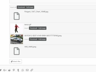

The image HAS uploaded to my server. It just wont let me actually INSERT the attachment.
I can right click on the attachment and open URL in new window
197022
If I grab that URL listed above and insert image it works.
I just cannot insert directly from the message window.
Files <=5MB work fine

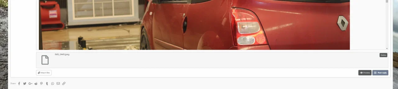

Thats a good shout - I have used centminmod and adjusted its settings. The file is actually being uploaded , but not made available.
This looks like a bug - I can drag and drop the image from explorer ( windows ) onto the message window and it inserts fine. It will not allow me to insert via the menu though.
