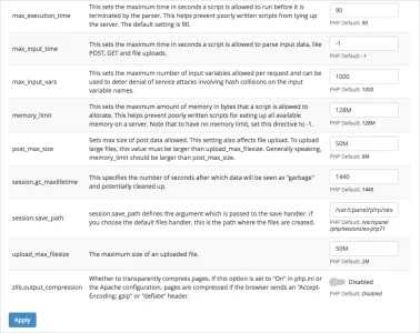

"Too large to be uploaded" is specifically an error relating to the server configuration. It will be the upload_max_filesize and post_max_size parameters in php.ini specifically.
