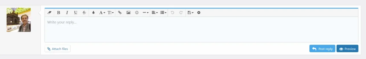

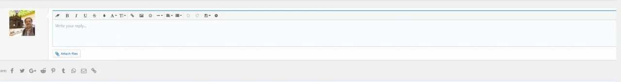

Two screen shots attached:
chrome and IE11
In IE 11 one has to scroll down quite a lot to get to the buttons. This is a report submitted by one of the users so I really cannot check as I am not on IE

I have a test install with no add ons and no changes to style. So I have requested the same user to do tests and then will change the two changes and repeat the test to see if it's the two changes or something else (add ons). Will update this thread with whatever the outcome is.
I'm not able to reproduce this in my tests. Can anyone else reproduce it?
You will likely need to see if this still happens on a 100% default style with add-ons disabled. (While you have a style that looks stock, I can see that there are some non-stock changes which may be relevant.)
Update:
Issue was this add on from @[xFv] https://xenforo.com/community/resources/xfv-sticky-sidebar.5823/
Removing that resolved the issue.
Thanks. Can be closed as not a bug!
