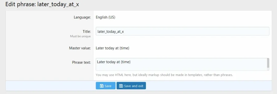

XF 2.2 I keep seeing "later_today_at_x" - how can I fix that?
drastic
When browsing the forum, it sometimes displays "later_today_at_x" instead of the date.
Sometimes it displays the correct info. Sometimes it doesn't :/
How can I fix that to always display the correct info?
Thanks

I was going to suggest that mod_pagespeed was involved - as it has been in the past with several upgrades.
So I am getting this issue now in Chrome but only when logged out. I do not see this happening here probably because there are no third party ad scripts in the code. Not using mod_speed. Not even using CloudFlare at the moment. Would need to see how to disable CSP now.
CSP checking tools tell me I do not even have one. No Content Security Policy found. Completely clueless what to do now!
Are you using XFOptimize? I found that the add-on does that when logged out. Disable the add-on and try again. I would recommend then reporting it to the add-on author if this is the case. Otherwise, no idea. I just remember the add-on did this when I was testing it but never got round to reporting it.
that makes sense. it is the only change i have made in a long time. would play with settings and report which setting caused this issue.
thanks for pointing this out! i was originally thinking that a new chrome update might be causing this. as most people reported this happening on firefox here.
