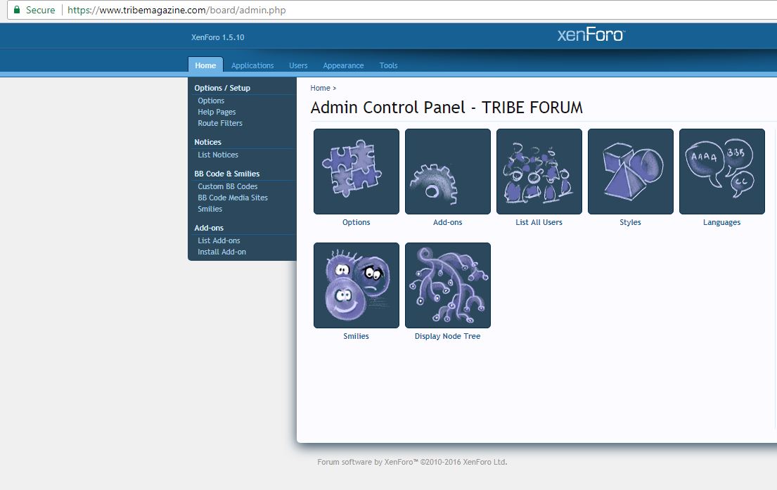

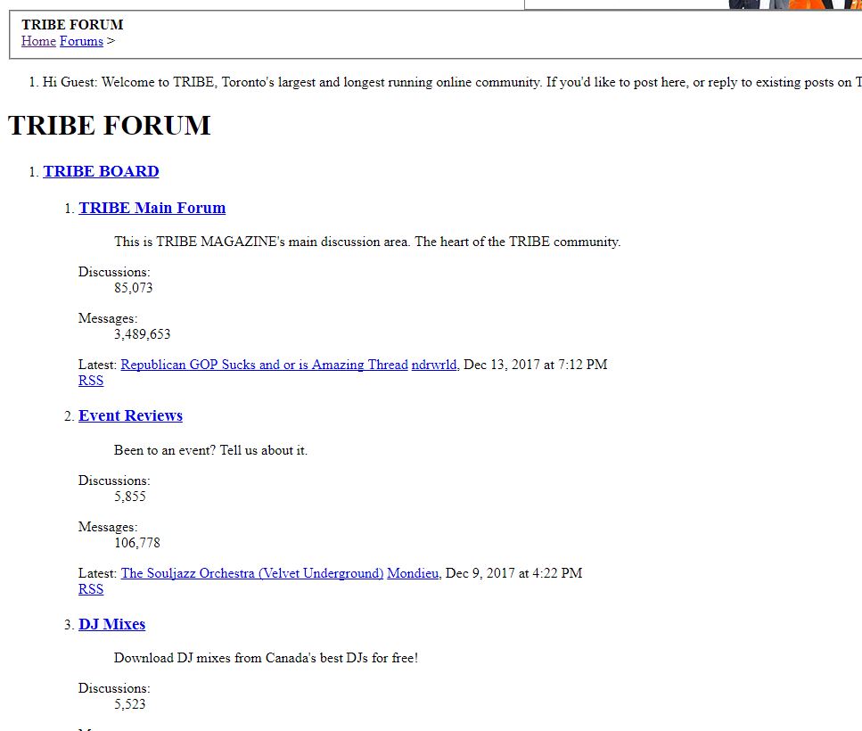

I have not been able to get https to work properly on my forum and I don't know why. It completely removes all the board formatting on the site, and many users, including myself, are now automatically being directed to the https URL by chrome. I am worried that people visiting the forum for the first time are seeing the broken layout and leaving. At this point I don't even know how to browse my own forum with http as it is continuously defaulting to https in chrome.

"I believe it’s because the CSS and the images aren’t getting loaded over HTTPS, and most browsers will refuse to load mixed content."
