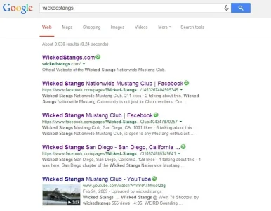

Ok, I need some help, @Jake Bunce @Brogan I just noticed that google has wiped everything that is on my site from there search engine. Only visible is the url.
I went from www.wickedstangs.com/community to www.wickedstangs.com
Below is my code can someone give me a hand please

Google Search

Google Search
