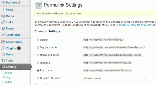

From my wordpress Permalink Settings, I want to use "Post name". To use it, I need to copy some lines at my .htaccess.
The problem is, when I copy that part of lines at my .htaccess file, I got error to visit my forum.
My forum is in root directory, and my wp blog is in "root/db". Here is my recent .htaccess file without any error.

And here is the code I need to include,
<IfModule mod_rewrite.c>
RewriteEngine On
RewriteBase /db/
RewriteRule ^index\.php$ - [L]
RewriteCond %{REQUEST_FILENAME} !-f
RewriteCond %{REQUEST_FILENAME} !-d
RewriteRule . /db/index.php [L]
</IfModule>
I just add this code "as it is" down bellow my original .htaccess, with no luck.
So, what will be my total code then?
