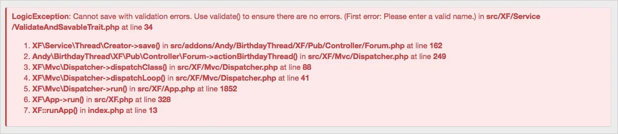

This is the error message if I run the code as not logged in.
Thank you.

#19 job.php(15): XF\Job\Manager->runQueue(false, 8)
#20 {main}
Or again, if you don't want the user to post their own birthday, pre-define a user in your add-on options and use that user. (this is what most people do)
