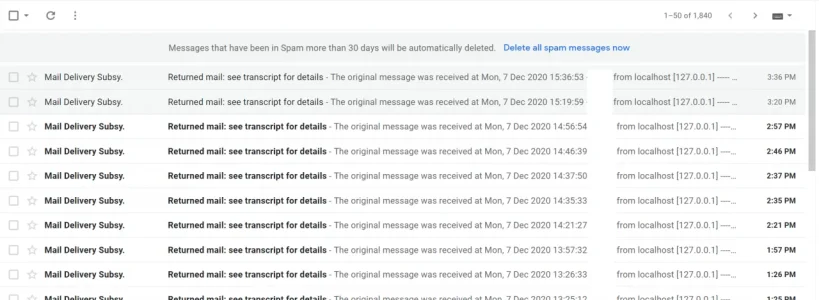

At first my site allow member register not have to verify email address, so they use false email address alot, which is fake email, spam email, etc... (like dsaddsad@gmail.com)
This happened long time ago, maybe years, I wonder how can I stop from receiving it ? It all go to Spam in my gmail
Here is details in email
The original message was received at Mon, 7 Dec 2020 15:36:53

Because these are all not exist email so I want to stop receiving it, can I turn it off ?

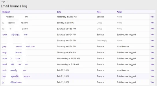

Yes it works VERY well, and is built in. I set it up per the instructions, and it will change the user's state when there is a hard bounce. (bounced status) On their next visit, it prompts them to pick a new email address. (and it stops trying to email them until then) Soft bounces are logged as well as auto replies. If you have that turned on in your email setup screen, you can view the logs at adcp -> logs -> email bounce log
Here is my log today, with the emails blocked out. "Hard bounces" get auto disabled by the s/w, so it wont send again until they visit and put in a valid email.

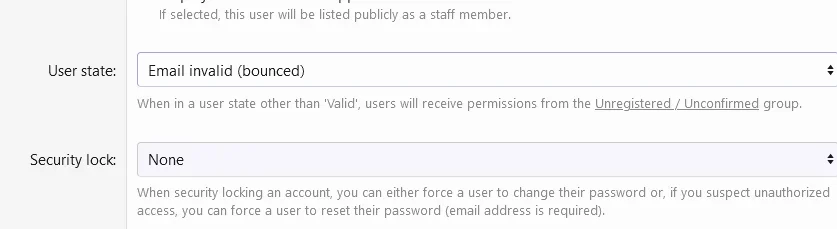

When there is a "hard bounce", it changes their status in the user record, to look like this:
