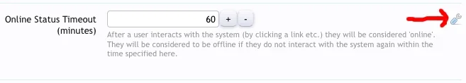

If you enable debug mode by adding this line to your library/config.php file:
$config['debug'] = 1;
Then you can edit the definition of that option to change the maximum:

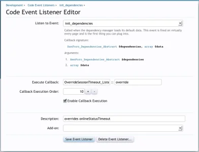

Then enable debug mode as before. Create a new listener:
Admin CP -> Development -> Code Event Listeners -> Create New Code Event Listener
> Listen to Event: init_dependencies
> Execute Callback: OverrideSessionTimeout_Listener :: override
Save that and you should be good to go. You can edit Listener.php to set the timeout. I have it set to 1440 minutes (1 day):
