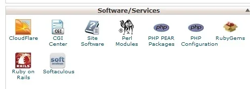

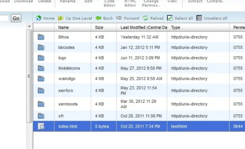

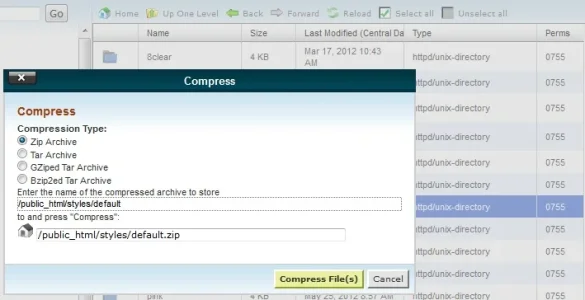

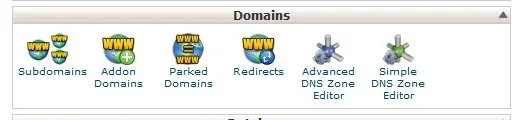

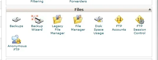

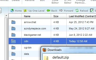

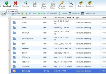

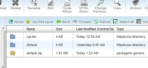

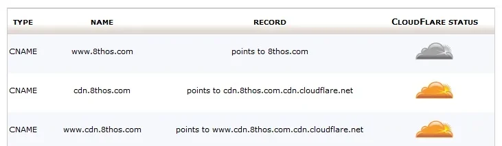

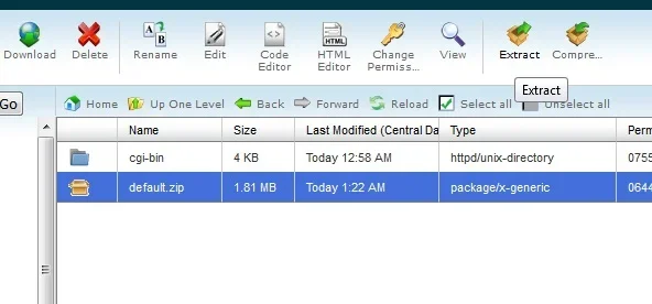

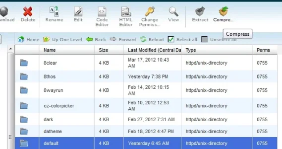

How To Serve Javascript and Static Images from Cloudflare CDN (version 1.0) - How to serve your static images and javascript from Cloudflare CDN.
Cloudflare

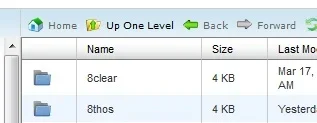

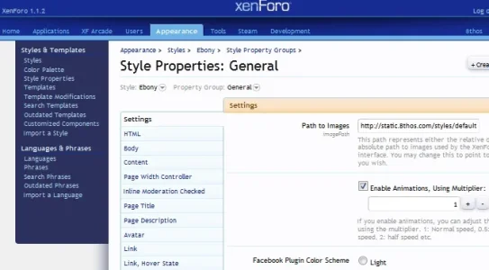

This basic guide is only for using Cloudflare to deliver our website's static images and javascript. Most of the directions are for cPanel and Xenforo Admin CP. I am using Cloudflare as an example because it's free and usually comes in most shared hosting's cPanel. If you need more in-depth and advanced instructions, ask your host or damoncloudflare.

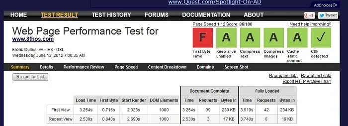

I will be using my site...

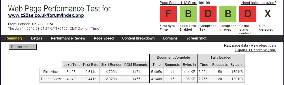

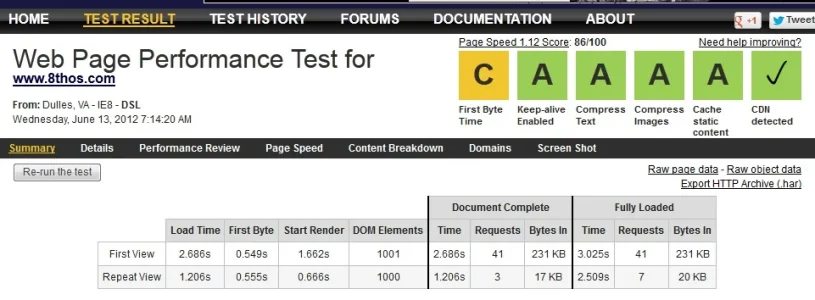

I just ran a test for your site and first byte time got a C for me. I wouldn't be discouraged by one test, there are more random factors involved, so try to average them out.

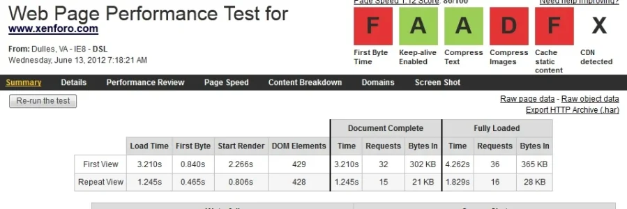

It would be interesting to see how much xenforo.com's score would raise by experimenting with Cloudflare.
http://www.webpagetest.org/result/120613_YF_D9M/

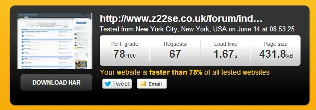

TBH, I don't pay attention to what WebPagetest says, it always shows slow for my forum, but the actual user experience is nice and fast.
Same page ran via Pingdom test
I've got my images and js being served from a cookie less domain set up (domain is www.z22se.co.uk, content served from cdn.z22se.com)
