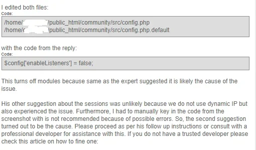

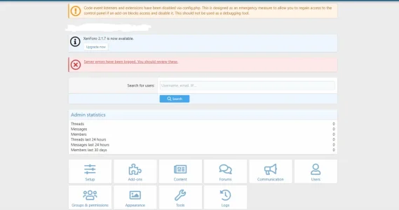

To be honest, I had to contact my host with your screenshot to ask them to do what your asking because I was lost. I have attached a screenshot of their response. I also attached a screenshot of what the dashboard looks like after I was able to login. I will be waiting for your response on how to proceed. Thanks!

The red banner which says “Server errors have been logged”, you may need to look in there and report back in case there are any clues as to what might have been causing the issue.
So, I clicked on it to see the server errors and it immediately kicked me back out to the admin login screen and now won't let me back in.
