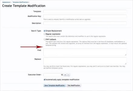

I would like to be able to replace all the contents in a template using the Create Template Modification system, is this possible?
You can maybe do it with a regular expression but unless you're releasing an add on you'd might as well just edit the template directly.
And if you are releasing an add on, don't replace an entire template :p
Currently I have my modified templates saved as text files. So when I upgrade I just copy/paste the text files over the default templates after reverting all templates. What I would like to be able to do is save the modified templates in the TMS in the Replace input box, that way when I upgrade it would easier.
Ideally there would be one more radio button that says "Replace entire templete" and it would be positioned where the red arrow is.

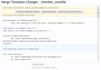

Look at this screenshot:
The two lines of code highlighted in yellow are where the XenForo version (parent) differs from the custom version (your own edit).
You get given a very simple choice:
1) Use the parent version and remove your custom changes.
2) Keep your custom version.
3) Keep both versions (this will probably not be a common choice for most things).
To give you an extra level of control, after you have selected one of the options you can actually edit the text directly (maybe you want to add more, or leave yourself a comment or something).
Finally, note the area in blue? Quite simply this is a custom edit you've made that has automatically merged itself, e.g. there's no conflicts. All you need to do is double check that you still want the custom change. If you don't, you can actually click to edit it or remove it.
Finally, click Merge Changes. Job done.
