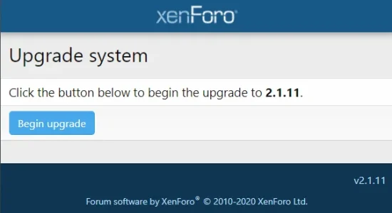

Ah, after your post I rechecked and saw it now wants me to upgrade to 2.1.11 again - I already did that successfully earlier tonight.
It lead to "oops we ran into some problems please try again" at first, but in the scond run worked OK.
But now when I try to do that again it always runs into problems (tried 8 times already) :/
just realized that while I start the upgrade again and again in the lower right corner it already says "v2.1.11" - now I am confused?

So now this is the cycle i am caught in:
Processing...
Importing... Master data (templates)
Rebuilding... Phrases
Rebuilding... Templates

You appear to have restored the 2.1.11 files, but I suspect you may have actually upgraded to 2.1.12 already -- with a change today, you would've been prompted about that upgrade before the 2.2.1 upgrade showed up (if you were on 2.1).
So if you upload the 2.1.12 files (you may need to download them from the customer area and do this manually if you can't get into the ACP), that would probably clear up the issue.
