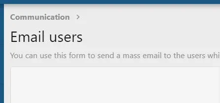

Exactly, but no email is sent. To do so add them to a group then send the group an email.

In my case, thousands of users had old/bounced emails. Mass emailing might be a bigger headache than it's worth.
