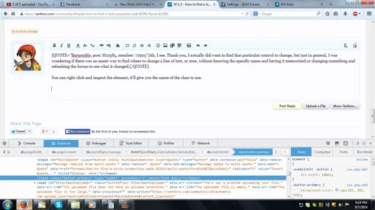

You can right click and inspect the element; it'll give you the name of the class to use.
For example, if I wanted to edit the Post Reply button in any way, it would look like this after right-clicking:
Okay. I was already trying that, but I found that the info it gave me didn't make things much easier to find in many cases because it wasn't specific enough on the path if it was inside one of the property areas.
But I still appreciate the help
