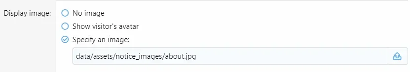

You can specify an image in the notices settings:
The image will appear above any text you add, which would be your standard HTML stuff using <p></p><br> etc. The image height will be the actual height of the image, so you will need to put multiple images that you want into one image, sizing them accordingly.

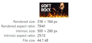

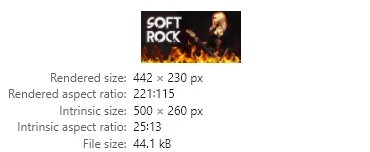

Just remember that whatever height you set the image must be at least that height. An example would be my site which uses an HTML front page where I assign the image size to be dependent on the <div> element and using an external CSS source rather than piling it all into the extra.less file. It's little more tricky but it works - https://rockmachine.org
The actual image size is 500 x 260px but the rendered size to fit the <div> column is 442 x 230px
On mobile it changes again for the smaller screen:
Actual size is the same, but the rendered size decreases to fit the smaller <div> column
