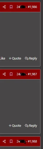

I was testing with this and I found the template code to be fairly simple.
For example I used it with random prime numbers to get a result which can be calculated back to a user ID (the one who is sharing those screenshots).
{{9 * ({$xf.visitor.user_id} + 23) - 2 * ({$xf.visitor.user_id} + 41) - 37 }}
You put that template code somewhere in post message template (maybe next or before the post number).
This simple math equation with addition, subtraction and multiplication is to simply throw them off about what that number is and not be able to connect it with their User ID or another known number.
In essence the above is a very simple math equation of
9 * ( X + 23 ) - 2 * ( X + 41 ) - 37 = Result number
Then it is a simple backward calculation to solve for X i.e. the resulting user ID.
USER ID = (Result - 88) / 7
