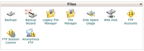

CPanel has different skins. But there should be a backup option when you login to CPanel:
Inside the backup area there is an option to both backup a database and restore a backup. You can download the backup, rename the file to specify a different database name, and then restore the backup. When you restore a database backup in CPanel it uses the name of the file as the target database.
