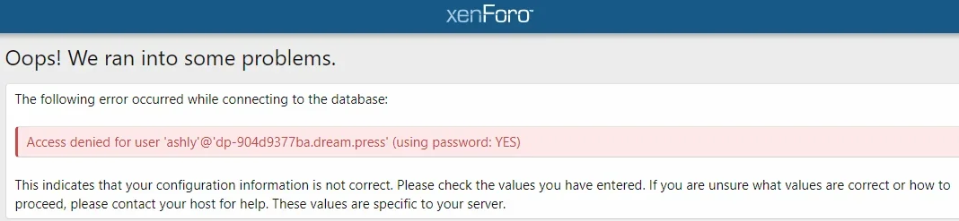

After the consolidation to the OR data center, I get this from the installer:
I've got the db server and db name correct per this:
And I got to the db via phpMyAdmin through the DreamHost 'panel' with the same login and password. Access denied sounds like a permissions issue and another call to DreamHost. What is "db-904d9377ba.dream.press"?

I have been with a2Hosting for less then a month, and installed XF2, and it was done within 2-3 min I guess. I am on a shared server, however, I maybe slowing down a bit due to all the addons since I am a "addon" freak, but so far, everything is working as it should....
as far as the user/db is concerned, snyc the user to the database, and select all privileges and save, otherwise,
you will get what you are seeing, and XF can and will not connect to the database if they are not set up properly using the correct password.
