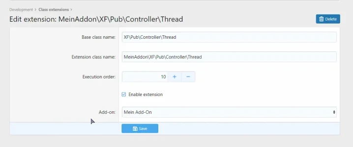

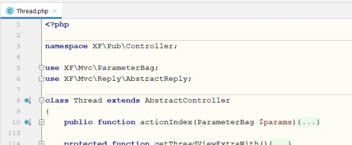

Example:
You want to overwite XF thread controller Methode actionIndex
Xour File in Path src\MeinAddon\XF\Pub\Controller\Thread.php
<?php
namespace MeinAddon\XF\Pub\Controller;

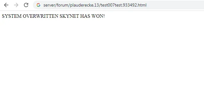

class Thread extends XFCP_Thread
    public function actionIndex(ParameterBag $params)
        print 'SYSTEM OVERWRITTEN SKYNET HAS WON!';
        exit;
