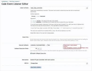

I assume my next step is to create the Code Event Listener. Here is the error I get:

I followed your instructions, but got a fatal error when I tried to view my forum. I suspect it has something to do with the Code Event Listener. Does this look correct?
OK the listener file I provided you with was not correct.
