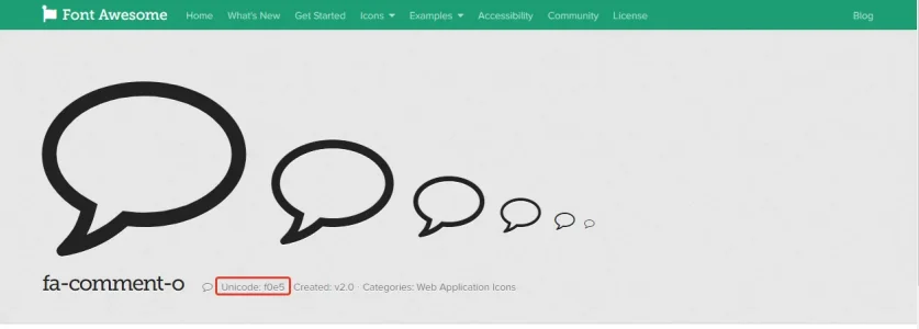

icon used by xenForo http://fontawesome.io/icon/comment-o/ Unicode: fOe5

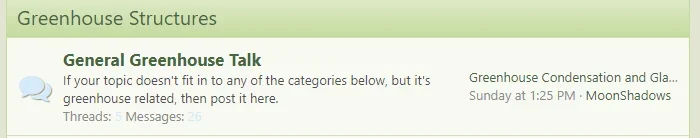

Demo:
It looks nice @MoonShadows :p(y)

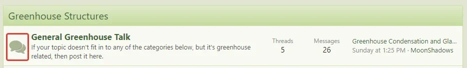

this actually displays both my custom icon and the FA icon. How do I get rid of the FA icon? Thanks!

this seems to work:
Less:
            .node--unread &
                content: url("path/topic_unread.gif") !important;
        .node--forum &:before,
        .node--category &:before
            content: url("path/topic_read.gif");
