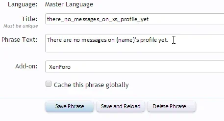

I think you're getting confused by the 'name=' part in which case the screenshot I posted has {name} in the Phrase text.
Have you tried what I posted with your code? {$user.username} is being stored in 'name' ({name}) for use in the phrase. Just like @batpool52! examples shows {x} and {y} placeholders.

upload_2015-8-9_0-15-37-png.113684
I'm not sure how this is confusing you?
{xen:phrase there_no_messages_on_xs_profile_yet, 'name={$user.username}'} is the code that goes in the template. (Change $user.username to $visitor.username if you're trying to use the current visitor's info instead). Then go create the phrase "there_no_messages_on_xs_profile_yet" (first parameter in the template call), with the content "there are no message on {name}'s profile yet." I've bolded the parts that match up.

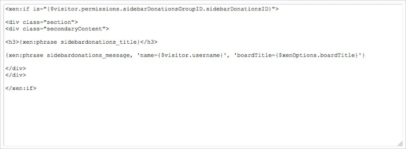

In the template code below I added two variables to the normal phrase code which will be passed to the phrase, {name} and {boardTitle} will both be passed to the phrase.
{xen:phrase sidebardonations_message, 'name={$visitor.username}', 'boardTitle={$xenOptions.boardTitle}'}

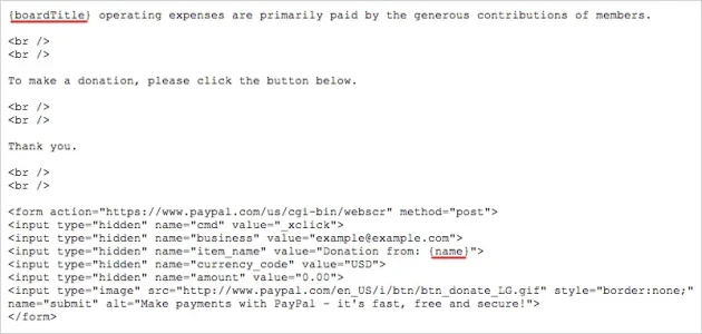

Example images:
Template
Phrase called sidebardonations_message
