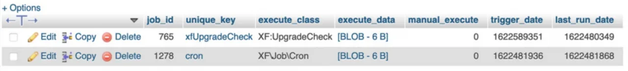

What is the method to restore a missing row in xf_job table?
There should be two rows like this:
But currently there is only one row like this:
You can basically insert job entry into table.
SQL:
INSERT INTO `xf_job` (
    `unique_key`, `execute_class`, `execute_data`,
    `manual_execute`, `trigger_date`, `last_run_date`
) VALUES (
    'cron', 'XF\\Job\\Cron', 'a:0:{}',
    0, 0, 0
