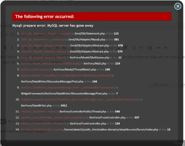

P: I get an error when attempting to load a page and it states "MySQL server has gone away".
S: This is an issue with your server and something your host will be the best to help you solve. If you attempt to reload the page/rerun the task you received the error on, it is a possibility that it will be successful. Here are some related links to this specific error:

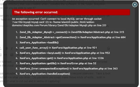

The first error effectively indicates that the MySQL server is down/unreachable, especially if it happens infrequently. The second error is covered in the MySQL doc entry, but it could indicate a timeout or that the MySQL server became unreachable/went down. If the errors are related, it would lean more to the server going down/becoming unreachable.
Of course, the question would be why this happens. If anything, it might indicate a load spike. The responsiveness you mention isn't related to server response (it's going to be related to your computer/browser), but if the server is slow in general, these errors are really just a symptom of the general load issues on the server.
Alternatively, it's possible that MySQL is being restarted for some reason. (You can check this: https://dev.mysql.com/doc/refman/5.0/en/server-status-variables.html) I would recommend looking at your MySQL logs as well.
The short of it is that XenForo can't directly trigger any of these errors. They relate to internal MySQL issues or configurations. (The "gone away" issue could theoretically be triggered if you have a low wait_timeout and a server that sends email very slowly, for example. You should increase wait_timeout then; the default is actually 28800 seconds.)
