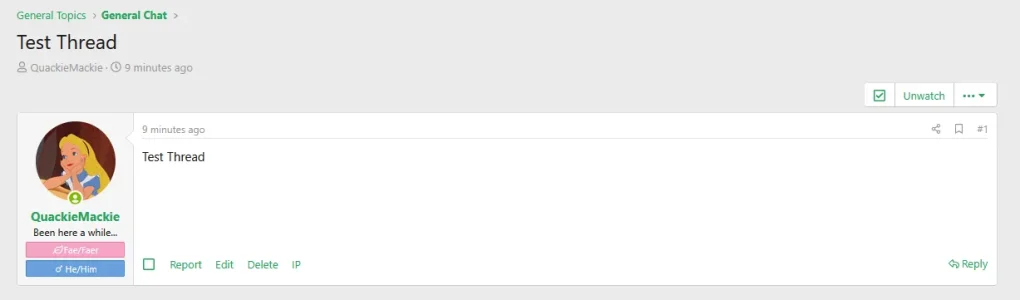

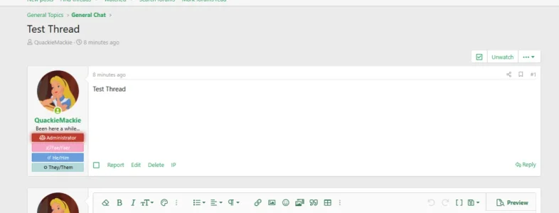

into the macro we can control which banners we'd like to see. So for example I'm only showing banners that contain this userBanner--syl_pro_fae_faer or userBanner--syl_pro_he_him.
This turns this thread
into this
Without us removing banners. The banners will still appear on the users profile. They just won't appear in the threads.

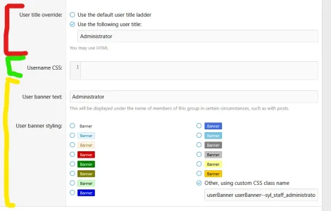

So for this example i'm going to have 3 groups:
  • Group: Administrator priority: 100 Title: Admin
  • Group: Moderator priority: 50 Title: Mod
  • Group: Member priority: 25 Title: User
So each of these groups have a title and a priority.
This can also be overriden by a user by them editing their account detail option:
User Title Override
It will pick the heighest priority in this case the group Administrator and use it's title. If Administrator did not have a title, it would instead use the group Moderator, if group Moderator did not have a title it would use group Member
Username CSS
This is where we can put css changes to affect the username of a group. So for example if we added:
CSS:
color: red;
into that field it would turn any user in that groups username red.
User Banner Text
This affects the actual text that goes inside the banner.
User Banner Styling
This is where we can either choose a style for the badge or add our own, to do this there's a guide here:

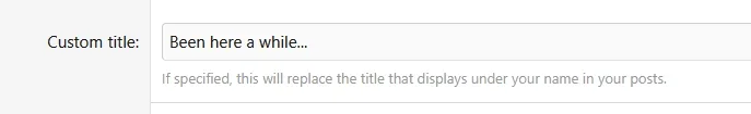

In acp at the user edit level you can do it here:
Profile info
Custom title
And if they are in a group that cannot add/edit the title it is controlled by admins.
