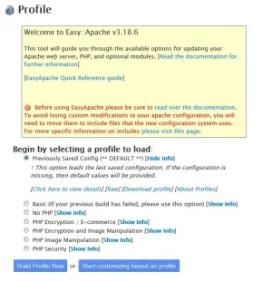

ok Matt, just finished backups now on to the EasyApache thing.. Which one do I select?
start customizing based on profile.
It's a step by step process to upgrade Apache and PHP, so you'll need to select the latest version of apache first, and then you can choose you PHP version. After that, you'll get some extended choices for PHP such as mysql / mysqli etc, make sure they are all checked (probably all ready are).
That reminds me. I need to go in and clean out some of those profile entries. There's about 2 years of 'em on my server. >.<
Below are not checked, do I check them?
