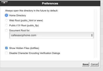

If I remember correctly you may just need to tick that box. (then URLS will no longer have /index.php and/or maybe other guff in them
If there is an issue then activating the xenForo htaccess.txt file (supplied in the files when it was installed) on your server where the xenForo installation is. Or copying the contents of that into your own htacess file if you already have one.
If you don't have an htacess file, you activate the xenForo one by removing the .txt extension and adding a dot in front of it so htaccess.txt becomes .htaccess
The dot in front makes it a "hidden" file in that it wont be visible unless;ess you have activated "view hidden files" or similar in your FTP application. On Cpanel File manager see settings at the top right
If there are iaasues then the contents of the file give you an instruction (see bold text)
