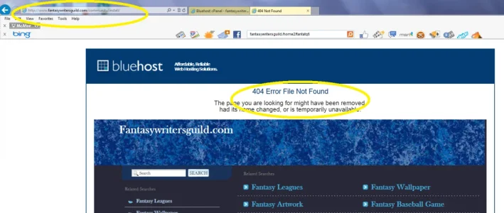

Greetings all.
I took the plunge and bought Xenforo.
Uploaded the contents of the upload file to a directory titled community on my site hosted by Bluehost.
Did the 777 permissions.
But ... when I tried to direct my browser to the install folder, I keep getting a 404 error.
What am I doing wrong?

Looking at your screen shot....
You did not upload it within public_html (or www). So you have your files in a non-public directory where only you can see them or access them via ftp (or in this case cPanel).
So in short it should be
public_html/community
(if community is where you want it, just like XenForo.com)
Ok, well, I tried both directories (www and public_html).
I still get the same error (see pics).

Are you sure you downloaded the full package and not just the upgrade package?
I've seen a few people do this by mistake. So you wouldn't be the first person to have done so.
I can take a look if you want. Send me a PM with log-in details.
