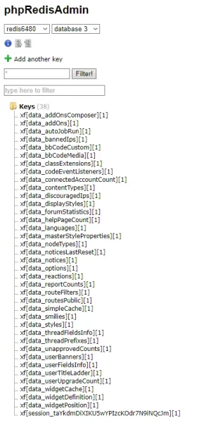

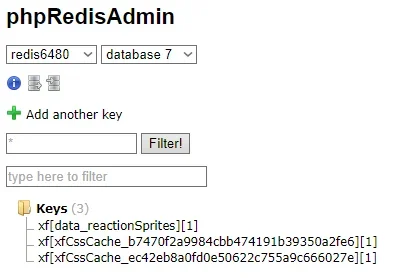

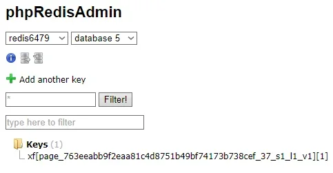

I think I have it configured correctly for redis caching on 2 instances of redis servers on port 6479 and 6480
In below config where does $config['cache']['sessions'] = true; setting put the cached sessions ? looks like within the global cache instance ?
That just enables session caching.
Generally speaking, cached data will look if there's a specific cache context for it. If there isn't one specified, in most cases it will fallback to the global context. The fallback can be disabled on a per item basis in code -- we do this for page caching for the reasons I've laid out.

View attachment 194859View attachment 194860
This works perfectly. Also have 3 instances, two for XenForo and one for Wordpress.
