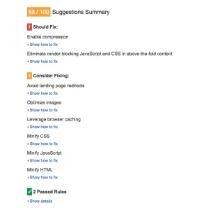

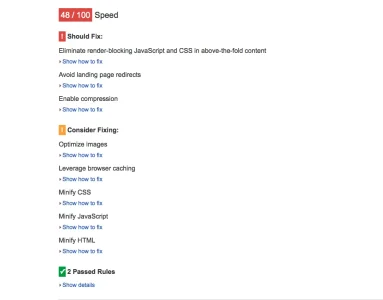

So I ran the PageSpeed Insights on my forum and the results dont seem like they are good. Does anyone here have experience with fine tuning this?
Here are my results, Red is Mobile, Orange is Desktop.
Any help to fix this would be appreciated.
Thank you!

First, check that the site is being hit on the new server. Compression is enabled with nginx.
The mininfy stuff can be set in the performance section of the options in the ACP. You can also set it to serve files from the cache as zendopcache is installed.
I can take a proper look when I'm back at work tonight.

That would be great. Thank you Matt!
I think pagespeed is still going to the old site (my work ISP is still going to the old version as well!)

Maybe i should give it some time to update, or is there something else i can do on my end?
