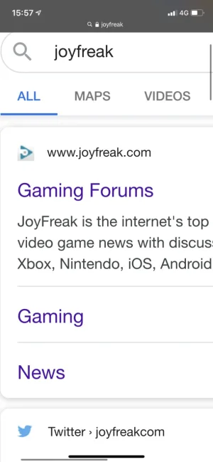

XF 2.2 Google displays Icon URL (192x192) rather than Favicon URL (32x32)

That’s odd because this must have happened today or yesterday. I always check my position on google, daily. I also haven’t changed anything so don’t know why they’ve decided to change the iconography now.

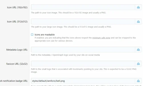

Yes I'd like to know more about this
On the ACP Style Properties there are three boxes to be filled in
Icon URL (192x192)
Icon URL (512x512)
Favicon URL (32x32)
Where are those images used?
here is a screen dump
I have put 32x32 favicon into the third field and that comes up on the tabs of each page in my desktop
But what are the other two fields for?
The documentation is not very helpful
