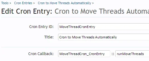

I've got the following cron entry:

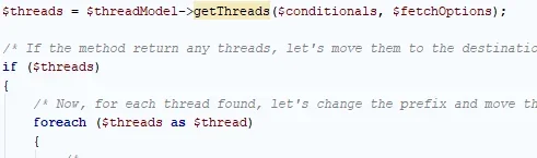

The Callback, runMoveThreads is super simple. It gathers all the threads in a given subforum:
It then moves those threads, one by one, to a new subforum. It is based on code from @Fuhrmann's tutorial on how to make a Cron Entry to move threads. I've been using it for years, so I know it works.

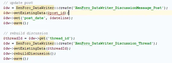

I'd like to change the post date for the first post in each of the found threads. For that, I need the post_id of the the first post in the thread.
Given the above code and the context of a cron job, how do I find the post_id of the first post of the thread?
The code I will be calling afteward is taken directly from @AndyB 's wonderful Change Date addon, so it is solid, too:
(Okay, I lie, there is a bit of code after that that updates xf_forum if the thread is now the most recent one, but I can handle that.)
