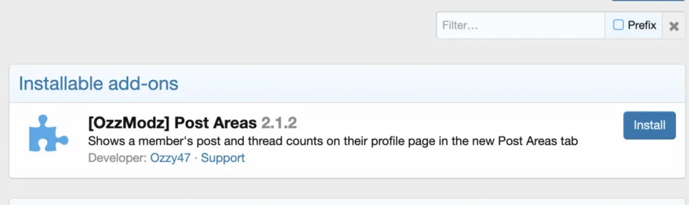

This is the piece I'm looking for clarification on. What would that path look like? Ex: I've used Post Areas add-on in the past and have uploaded the new files to my xf2 install:
Should I expect there to be an "upgrade" option in the dropdown of the legacy add-on?
I think it'll show in a dedicated area to the top like "Installable Addons", just worded something like "Upgradable Addons". That specific addon probably doesn't have an xF 1 to xF 2 upgrade path, but you can confirm with Xon in his addon thread.
