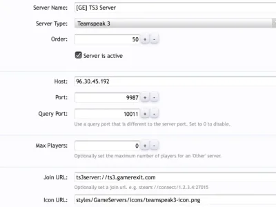

Ok, as per the workaround in the FAQ, you need to change the query port in the edit page to 0:Yes stays at 0
I changed that line to: xxxx

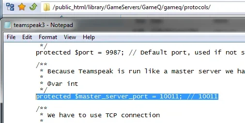

In the server options, set the port to the port you use to connect to your server, and set query port to 0.
In the file I was talking about, you should change the xxxx to 10011 as that is your query port.
Once you've done that, it should work.
I will update the FAQ to make it clearer
Edit: By the way, you can use the hostname (ts3.etc.com) in the host field if you'd like. It doesn't need to be an IP address.

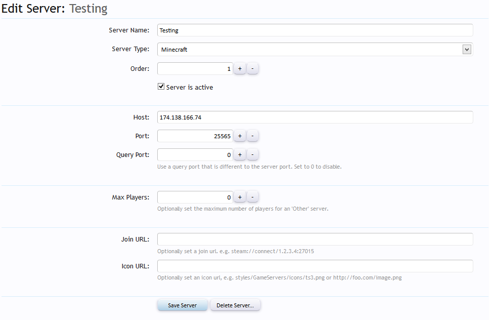

Can you try adding this minecraft server and seeing if it works (use the update servers button):Yeah, restarted the server each time I changed it.
Currently it is 25566. IP is 198.50.201.236 if you wanna test.
174.138.166.74:25565

Okay, I tried the other server you provided, with the server port set to 25740 + the query port set to 25740, && the server port set to 25740 + the query port set to zero. Got 0/0 players both times.Ok well I think you have two issues. The webserver and the MC server. We'll deal with the webserver first as that is more important.
Given that the test server (174.138.166.74:25565) doesn't work, that suggests it's your web server as that is working for me. You can also try this server: 216.158.77.210:25740
