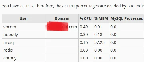

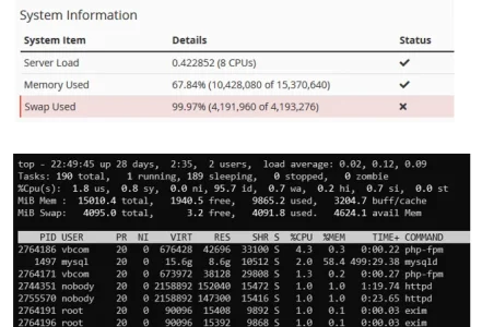

Last night I found my 16 Ram VPS and MariaDB10.3, the SWAP memory partition was almost 100% and Ram memory usage 68% (57% of ram is for Mysql alone), the load average was normal and I am on XF2.2.12
Am I in critical situation? if yes what should I do?

When my VPS swap hits 100% the Ram memory usage was 68% which means my VPS wasn't running out of memory there was still 33% available and also the VPS average load was very normal and my XF forums was running normally
It's not quite as simple as "there was enough memory". The operating system is what decides when to use (or not use swap). So for example if you had 33% of total memory free but that 33% was split into a zillion tiny chunks of non-sequential memory, it might choose to use a sequential swap vs. 5,000 non-sequential small bits of RAM. So the "total free" doesn't tell the full story. More specifically, Linux has memory "pages"... and a full "page" of memory is what it cares about when dealing with swap.

I forgot to mention that even though your current RAM usage is 67%, that may not have been the case when the swap needed to be used. So if your server was overloaded at one point, swap kicked in, and then it went back to normal, the swap will persist normally. Swap usage is a good indicator that the server was out of memory at some point, but not necessarily now. If you want to reset swap usage back to 0, the command I gave you previously is what will do that (turning swap off and back on):
swapoff -a && swapon -a
Again... normally Linux doesn't reset swap back to 0 even when it's recovered from a resource overload event.
