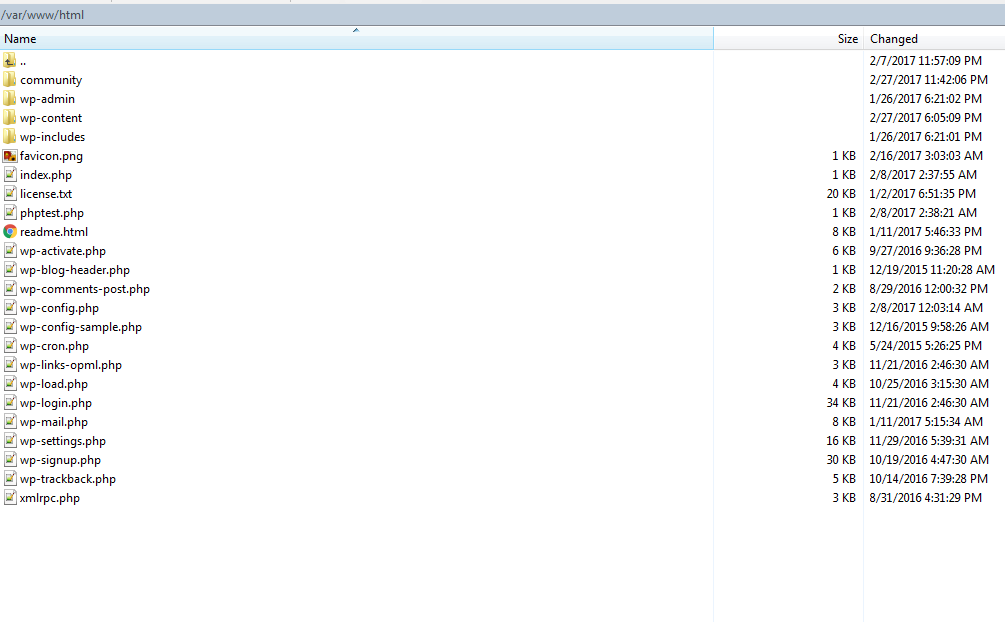

https://gyazo.com/d2bdc5e8f59578bc3f1e53f35c64350f
I have enabled mod_rewrite
I have ensured that its installed
I have also setup the .htaccess file and restart httpd
I have Wordpress running @ site but I don't believe that will be an issue.
.htaccess in the root of XF dir > http://paste2.org/wxht3eYB
I have also ensured that AllowedRewrite is enabled.
So far I'm at a loss here and maybe I can get some help from experienced users on why this isnt working.
