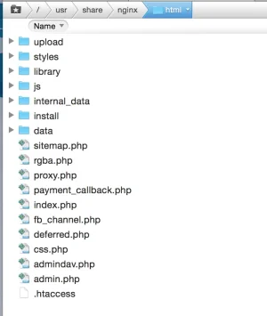

I'm trying to get the friendly URLs working on my website but the pages keep going to 404.
Here's the config if anyone wouldn't mind helping. Don't I just paste this at the end of my nginx file?

Yeah I should have done that @Tracy Perry but I even tried the default setup and I still can't get it working. If my install is in the web root, shouldn't this work?

I used the default one provided by XenForo – any idea why that wouldn't work though? I kept getting a [failed] to restart when I pasted it in the bottom of the config, where I assume it should be pasted ...
