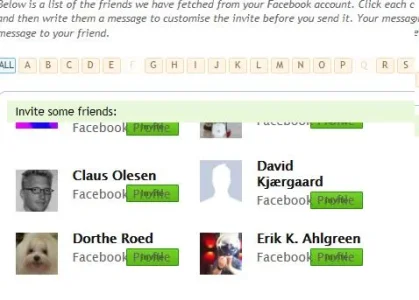

Working nicely, but for Facebook I have problem, no check-box to select the users to invite, and a link to to facebook profiles is above invite.
First, there aren't check boxes anymore. You have to do them one by one, hence, the button instead of the checkmark. The old way, with checkmarks and mass posting, was against the Facebook TOU. That's the main reason for this change, to conform to Facebook's rules.
Your second issue seems like a styling issue... almost like the columns are too narrow. Mine looks normal. Have you tried viewing the Invite page on a non-customized style? Maybe you have a customized template? Also, what browser are you using?
Thanks. I have inserted a couple of <br> in the template, and not it looks OK, also here. Thanks.
