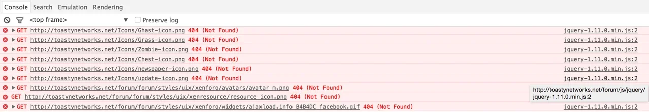

You appear to be using custom icons in your theme (and the default XenForo theme too, I switched to that and checked).
Looking at the console, there are 404 errors as it's looking for the icons in their original location:
You need to change the settings (presumably in your styles) to point to where the icons now are.
