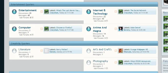

I have been searching Google to see if there is a theme for this or whether it is in the styling options at all.No i don't mean sub forums as grid either.I have took a picture of what i would like and whether it is a theme or whether it can be done by template edits,Can this be done for xenforo

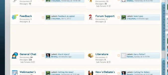

The problem is that the node title goes over two lines on some nodes, meaning they have a bigger height than the others, which offsets them. Probably the easiest thing to do is to just set a height on the first css rule in my code.

This is what i am getting mostly the ones which have sub forums
