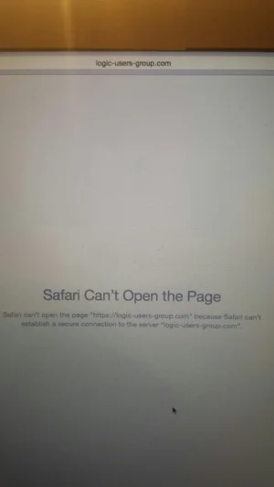

OK, so this seems to be only one user who is saying my forum at https://logic-users-group.com is not opening in safari.
It works fine for him on other browsers, and works fine for others on safari.
running OS X Yosemite 10.10.5 and Safari 10.1.2. I've tried clearing the cache, cookies, disabling extensions, restarting my wifi, and resetting the DNS servers. It seems like an encryption issue? I'm also unable to see a certificate for the site in Keychain Access.
Any idea what might be going on here?

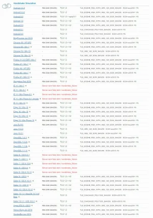

Currently your site looks like this:

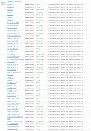

adding those 2 ciphers would eliminate your handshake failures for those old browsers:
