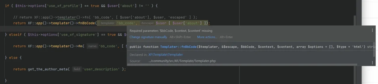

I've tried this code but it clearly isn't correct and states items are missing. The 'bb_code' is $bbCode.
return XF::app()->templater()->fnBbCode( 'bb_code', $user [ $user['about'] ]);
Can someone please explain to me the parameters? Maybe there is a file in XF that uses the fnBbCode and so I can use it as a reference.

Ah, I should have reviewed the arguments more closely. The second argument to func is an array of arguments that will be passed to the template function. You can look at fnBbCode to see what arguments it takes. The first two arguments are passed automatically, so you do not need to consider them.
PHP:
public function fnBbCode(
    $templater,
    &$escape,
    $bbCode,
    $context,
    $content,
    array $options = [],
    $type = 'html'
That leaves you with:
  1. $bbCode -- the string of BB code you want to parse
  2. $context -- the rendering context, typically the content type and maybe a sub-context separated by a colon
  3. $content -- the content entity or user entity of the string being rendered
  4. $options -- an array of renderer options (defaults to an empty array)
  5. $type -- the type of renderer to use (defaults to the HTML renderer)
Only the first three of these arguments are required. In your case, I would presume this corresponds to:
PHP:
\XF::app()->templater()->func('bb_code', [$user['about'], 'user:about', $user]);
