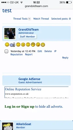

When there is a page load - there is 'a flicker' effect.
An example.
The forum home initially loads as "Latest: Jan 19 2014 at 8:07PM" before changing to "Latest: 28 minutes ago"
This happens within forums too, and the navbar loads without Home/Resources/Members before eventually appearing.
It's really off-putting. I've attached examples below and the test forum here - any advice very welcome
Mobile;
Desktop (I click forum twice in succession, hence the two 'flickers')

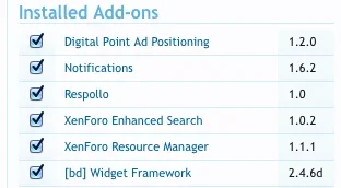

List of Add Ons (this error occurs will all disabled)

I listed by Add Ons in the OP (at the bottom) I don't have many and the problem persists with all disabled.
I also reverted all JS templates (I edited very slightly to include AdBlock Detection)

The main headache is viewing on a mobile (Safari), the navbar links jump on every page load. I just installed a fresh default style an the problem doesn't occur, so it's something I've done but I can't seem to isolate it to resolve
