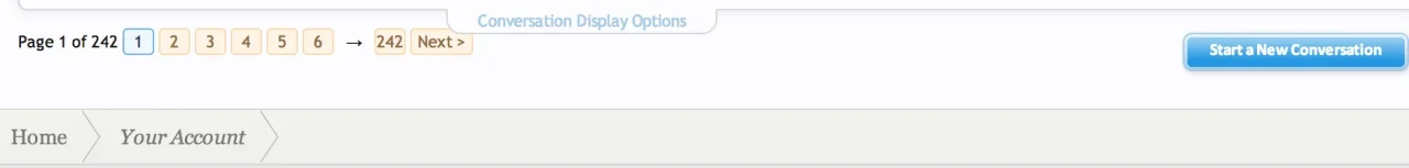

Just notice something that appears like a bug
On both XF 1.2 and 1.1.5, the Conversation Display Options panel at the bottom is not centered. This happens to other form that use this option panel.
Thank you, Russ.It's due to an outdated style property more than likely(I ran into this updating my styles)
Style Properties -> Discussion List - > Option Panel Handle Link, just revert the customizations then re-apply any you see fit.

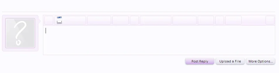

Revert editor related templates.Your code solved problem with the header perfectly
Still, the reply box is not working. Please see the attached file.
I hope you can fix this too, thank you.![]()
