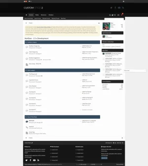

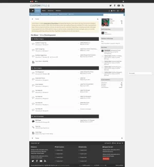

Just a quick heads up I've included a couple "Child Styles" which are basically edited versions of Flat Awesome + to get you going quicker. To use them simply install as normal with the final step being slightly different:
  • XenBase (first)
    • Flat awesome + (as a child of XenBase)
      • Import Child Style 1 or 2 (this will be your live style)
Once you import the Child Style 1 or 2 you can simply rename them to whatever you want your main style called "My site". All of your edits will go inside the Child Style 1/2. On upgrades DO NOT import and overwrite the Child Style XML's overwriting your own. You'll only import and overwrite XenBase and Flat Awesome +
Previews of them:

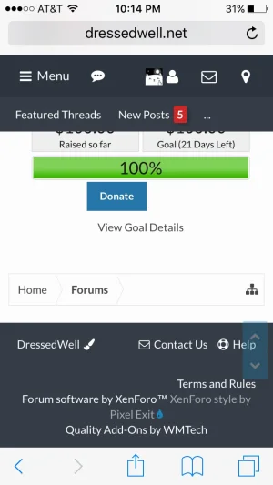

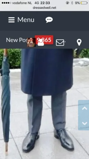

Seen a few reports of this type of error on mobile as well:

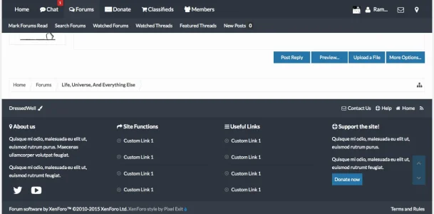

Getting reports of this when quoting a post on desktop. Happened to me a few times as well. Screen will skip down to the bottom for some reason and you have to scroll back up to see what you're typing.
Ok just had a chance to try it. On first blush it seems to be firing much closer to the mark. It stops just above the bottom of the header bar. When I go to reply it loads the quick reply at normal height as well. Haven't had a chance to check on mobile but will observe and report back.
What phone is this exactly? The screenshot is literally making it seem like the width would be around ~220px
Shooting you a PM regarding this...
