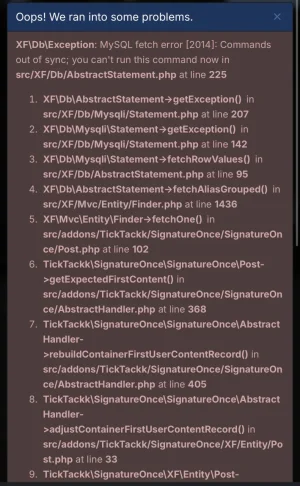

Out of the blue users started reporting slowness/“parsing” errors, etc.
I made a couple of test posts and one took like 10 seconds to post and on another I got this:

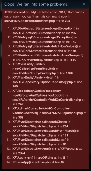

So, I saw that the add-on signature once might have been a problem and I went into add-ons in the ACP to try and disable it. If I click on the gear icon for any add-on I get the following:
No idea. Do I need to submit a support ticket?
Thanks in advance for any help.

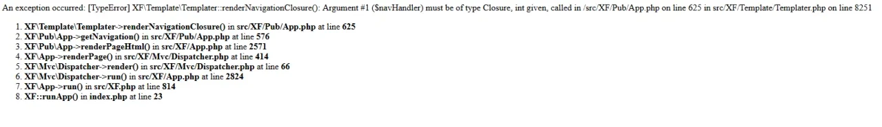

I disabled all the add-ons to try and remove the one that might have been causing problems and then just reenable them and now I get this:
I couldn't even use the ACP after disabling the add-ons.
Can I restore from a backup? How do I do that? What’s the point of these things?

If you are on xenforo-cloud, there's not much you can do I fear. You don't have ftp-access or access to config.php?

If you have access to the config.php file do this and see if that gives you access to acp again.
  1. Navigate to your XenForo root directory on your server.
  2. Open the file located at src/config.php.
  3. Add the following line to the end of the file:
    $config['enableListeners'] = false;

pasting the error text as well as the screenshots can be useful.

I can’t even get anything now. “An unexpected database error occurred. Please try again later.” that’s what you get when you visit my site, if I try to use the URL for the ACP, etc. Completely bricked.

Errors usually don't just happen out of the blue. Something triggers them. In this case looking at the screenshots that you posted it looks like an add-on called Signatures Ones is the culprit. You can read more about the error at the MySQL official site.

I’m not saying the errors came out of the blue, as I posted some. Additionally, there were probably errors in the ACP that I didn’t understand or thought were meaningless. Completely own that mistake.

I asked because if you had access to your Admin Panel you could disable said add-0n and hopefully that would have been the end of it.
The signature once add-on, is it this one by any chance?
I am asking because it says there that it's not compatible with the latest version of XenForo and php. A word of advice, if I may, whenever you install a third party add-on or style, make sure that it's compatible with whatever version of XenForo and php that you are using. Otherwise it will cause issues.
