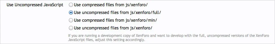

Use the option described above if you want the non-minified versions to be used.
Hi King Kovifor,
Thank you kindly for taking the time to explain how to use the non-minified version, that worked perfect. I'm really impressed with your knowledge of Xenforo.
Using the full .js files requires the following:
1) Put in debug mode (this allows Debug Options to be visible)
2) Admin CP -> Options -> Debug Options
Select Use uncompressed files from js/xenforo/full/
3) Take out of debug mode
