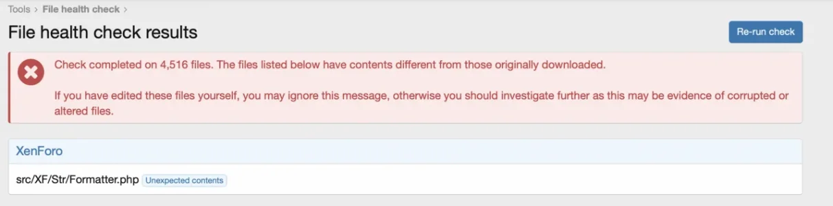

tommydamic68 Well-known member Nov 23, 2018 #1 a. is this normal after updating the file that was recommended? Formatter.PHP b. is there a way to get rid of the error in ACP?

K Kirby Well-known member Nov 23, 2018 #2 a) Yes b) Perform a full upgrade to 2.0.11 (recommended) or manually adjust hashes.json (strongly not recommended) Upvote 0 Downvote

Mike XenForo developer Staff member Nov 23, 2018 #3 If you did the patch, this is expected. To avoid this, you would need to do a full upgrade to 2.0.11. Upvote 0 Downvote

Ambient Vibe Active member Nov 26, 2018 #5 I did the full upgrade after I encountered the same error as tommydamic68, but the error is still persisting in the ACP. What should I do? Upvote 0 Downvote

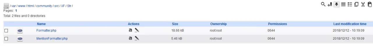

Robru Well-known member Dec 12, 2018 #6 Mike said: If you did the patch, this is expected. To avoid this, you would need to do a full upgrade to 2.0.11. Click to expand... I did a full upgrade from 2.0.10 to 2.0.12. Problem still exists. What to do now? Upvote 0 Downvote

Mike XenForo developer Staff member Dec 12, 2018 #7 Have you re-run the file health check since upgrading? You may be looking at an old result. Upvote 0 Downvote
tommydamic68 Well-known member Dec 12, 2018 #8 Robru said: I did a full upgrade from 2.0.10 to 2.0.12. Problem still exists. What to do now? View attachment 190407 View attachment 190408 Click to expand... I ran the file health check system again after the upgrade it it went away. Upvote 0 Downvote
Robru Well-known member Dec 12, 2018 #9 Mike said: Have you re-run the file health check since upgrading? You may be looking at an old result. Click to expand... I had not thought about that, Mike. The problem has now been solved after the re-run health check Thank you ! Upvote 0 Downvote
